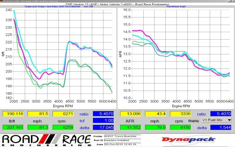

Here are some dyno sheets that I have for some before and afters. For those that don't know me, I have a 07 GT auto. my before was almost bone stock, had spacers, axle back, and ETD.

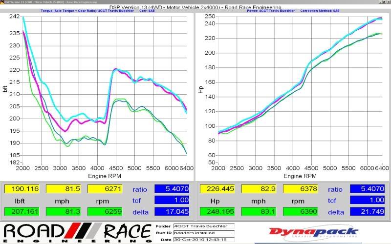

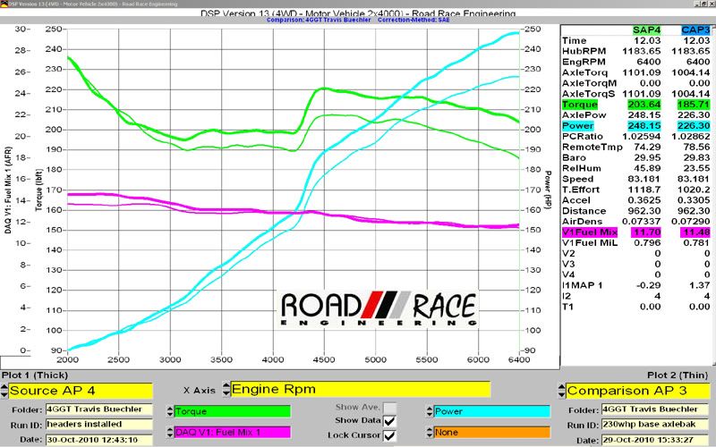

The Before & After for the headers are pretty much self explanatory
Before & After RRE Headers:

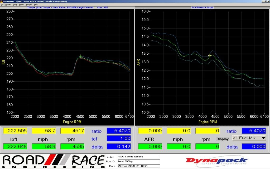

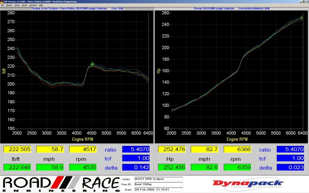

The blue and Green line are the after y pipe
After I had the custom y-pipe made:

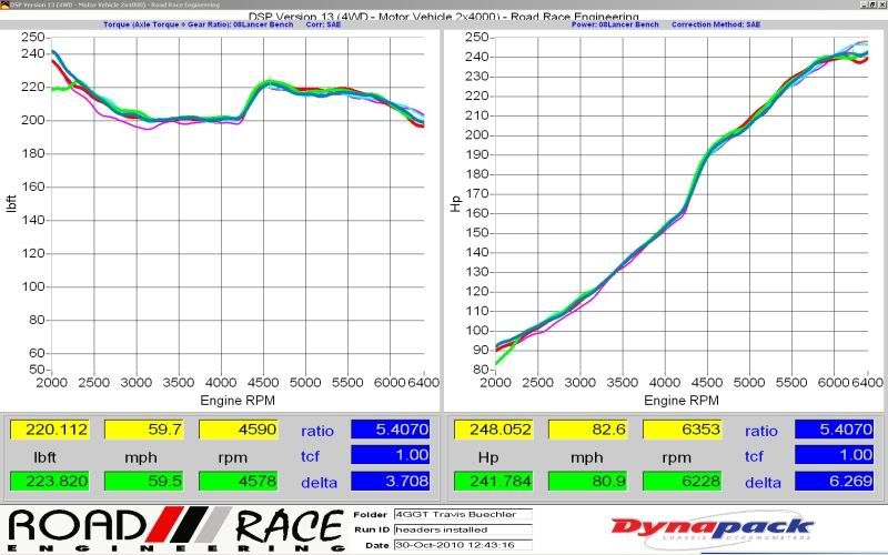

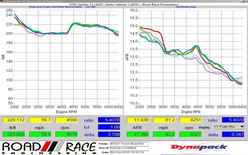

The Green, Dark Blue, and Red are the after CAI
After CAI

Am I reading this right?
Stock you were at:
190 lbft tq and 226hp
Headers installed
207 / 248
Y-pipe isntalled
223 / 252
CAI install
224 / 242
So with the CAI you gained 3 lbft of tq and lost 10 hp? Or are your dyno sheets no in chronological order from when you did your dyno pulls?

depends on what rpm you are looking at. the before and after for the headers was at around 6300rpm. so yes so far the numbers for stock and headers are correct for how you have it.
now if you look at the before and after for the y pipe, its at 4500rpm for tq. But if you look at 6000rpm before was around 212ft lb tq, and after was about 218ft lb tq. For the HP they kept it at the same rpm, almost around 6400rpm. Before 248hp, and after 252hp.
Now with the CAI installed it has gains throughout the power band up until 6000rpm. After that is when it fell on its face. So yes your looking at a 10hp loss. Hope that makes sense.
All the dyno sheets are in chronological order.

Yes I understand it. Your next step should be an FIC and get it tuned so you don't fall short on the top end. You're going to want that 10hp on highway pulls.
