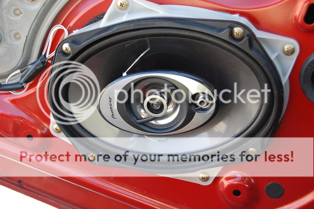

Ok so I have been seeing alot of how do you install new speakers or remove the door panel so here is what I did a while ago.
ok well here is the tut im starting to work on.
First this was a close to 2hour thing for just the doors mainly cause well I was scared to hurt the car since I wanted this job to be perfect. and at this time its not even close so ya.
First are what you need.
a screw drive both - and +
10mm deep socket with an extender and a ratchet
something strong to undo the clips on the door panel
somethings you might want
wire cutter
electrical tape
or
something (i dont know what its called) but it makes the adapter fit into another adapter to go into a coax.
First I took out all the screws and where I thought would be screws. like in the normal areas.
2 on the out side of the panel.

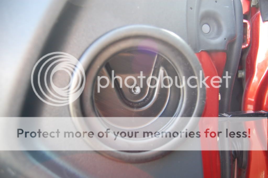

1 on the cup where the air goes through.

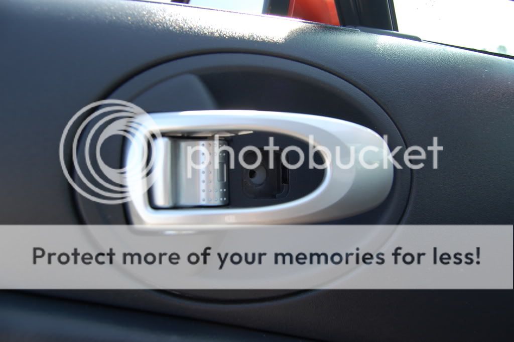

1 where the door handle is.

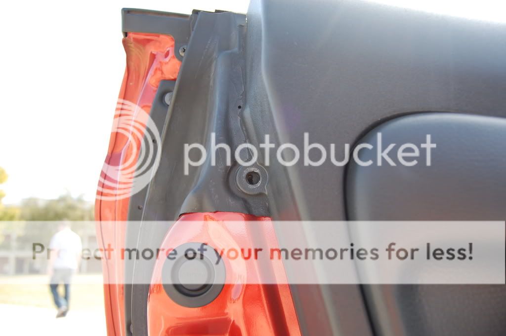

next was the 10mm bolts on the door handle
so I poped off the cover and on both ends were 2 bolts.

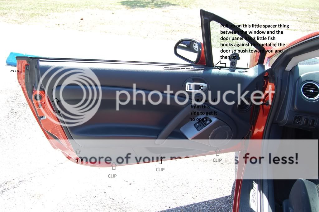

Now undo all of the clips that are holding the door they are very hard to get off and looked strong so just get it off. By sliding something the a flat ended screw driver thats been taped so you dont scratch the car.
Now Just pull up you will have to swing the bottom of the panel away from the door just a tad and pull up. It will seem like you are stuck but after spending 15min loking for other bolts I found out that there isnt any so just pull UP.
Then disconnect the window/lock control wire from the door panel.

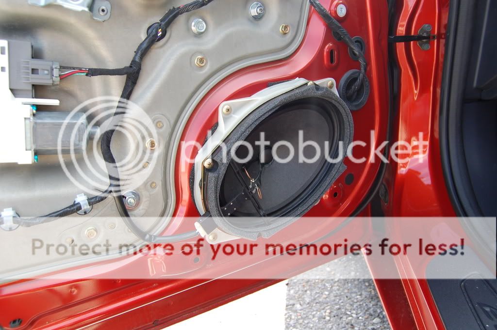

Next I took off the speakers it has foam around the side to keep the vib. down and is sticky so just take the flat ended screw driver and just pop it off.

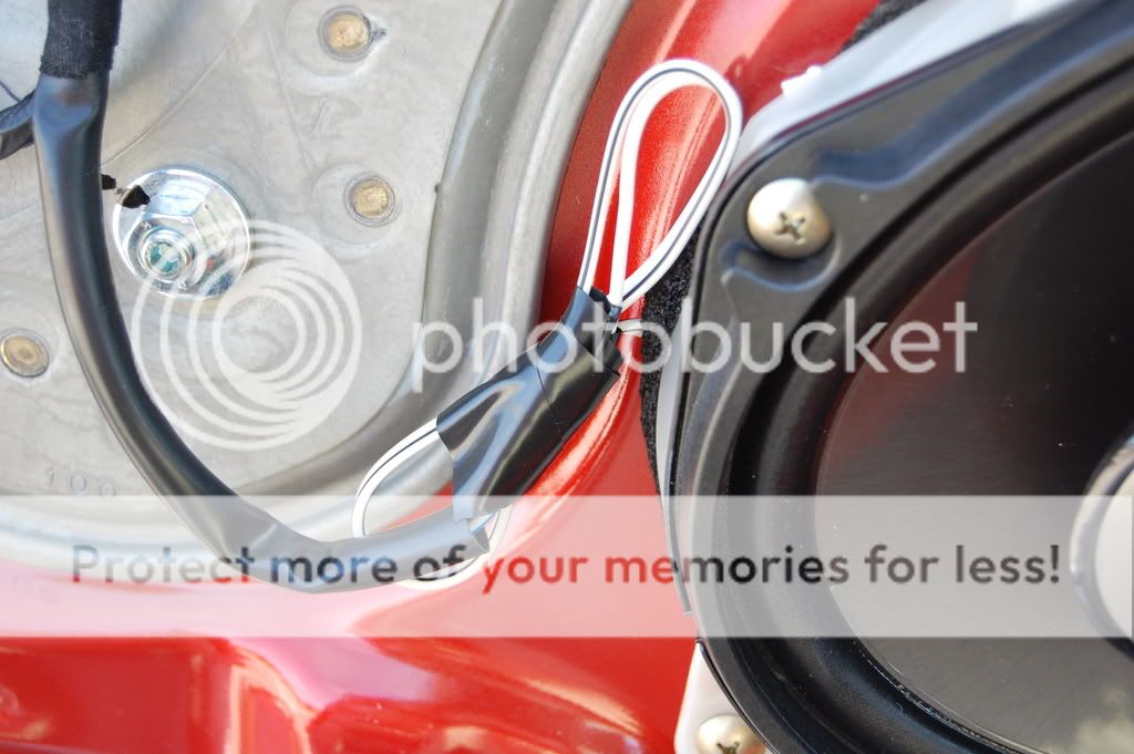

Next I myself thought that it came as a coax so I didnt get the adapter so I ended up splicing the cables into coax. Both wires give a 12V + according to 3 multi meters so I to the Black and Blue wire with the White and Black and the Blue and White with the all White for both sides.
Now I took off the plastic adapter that mounts the 6x9 to the door and put the wire between the two mainly to keep things attached.
Then I hooked up the speakers.
Then once that was all done I turned the car on and listened to the music and because these were 3ways I had to turn the TREB way down to -6
Then I put the trim on.
First put where the window goes the weather inner strip on first and then things will fall/swing into place.
Now tighten the bolts not to tight but firm so you dont strip the plastic thats holding the screws.
and now you are done.

Wow I bet if you do more of these you could make some money. Looking at this makes me feel comfortable in doing this setup. Very Detailed Good Job

Oh and incase anyone is wondering the grey speaker cover on front door have 3 or 4 screws that go onto a plastic shaft, not really threads as the screws eat into the plastic and lock it in place. There are a bunch of other Plastic tabs, that obviously Mitsubishi bent and melted into place..... So if you do remove the cover, you WILL be gluing it back on... JB WELD is pretty good if you do decide to remove speakers..

Pro tip: there is an opening at the bottom of the panel where you can start removing the clips.
