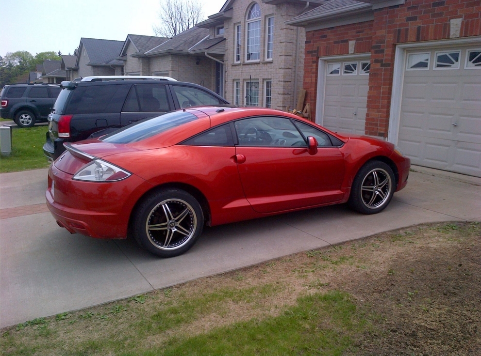

Starting point. May 2015
(2021)
Tire Wheel Vehicle Land vehicle Car
(Aug 3rd 2016)
Engine/Driveline:
Evo 8 16g 10.5T
Custom wastegate actuator
Evo 8 3 bar MAP sensor
TiAL Q blow off valve
FID 1000cc injectors
AEM 340lph pump
Magnus fuel rail (4G63)
Custom full return fuel setup (-8 feed, OEM feed as return)
Turbosmart E-boost Street electronic boost controller
3 inch custom exhaust
Magnaflow turbo muffler
Modified 4G63 intake manifold
Custom tubular twin scroll manifold
Intercooler (32*3*12)
2.5" charge piping
3" intake pipe
Custom 3.5" MAF
Throttle body bypass (runs coolant to the turbo now)
Fastworks Tuning software, self tuned
Clutchmasters FX400
Energy Suspension shifter base mounts
Torque Solutions shift cable bushings
Energy suspension motor mount bushings
BC Racing rods
Wiseco pistons (0.5mm over)
ARP head studs
ARP main studs
ACL rod and main bearings
Exterior:
Lighting
ACI flat black projector lenses
50w LED Fog Lights
60w LED Low Beam
60w LED High Beam
LED Turn signals
LED backup lights
15% tint all around
Black accents
Evo 8 Brembo brakes
Max Performance Carbon metallic pads for track, carbon ceramic for street
Cryo treated chromoly brake rotors (Centric makes these)
Lowered 2.6/2.5 inches on Tein S-Tech Springs
Debadged rear
Fog light grilles
Interior:
Lighting:
Replaced stock bulbs with LEDs
Glowshift Triple Gauge Pod
AEM wideband Air Fuel ratio gauge
AEM oil pressure gauge
Bosch Oil Temperature gauge
Terracotta interior swapped in
Charcoal headliner
125w RMS speakers
Wheels:
18x8.5 Motegi Racing rims
Goodyear Eagle Sport 235/45/18 tires
17x8 Eagle rims
Hoosier 235/45/17 slicks
I hardly update this page. It's probably out of date strongly.
