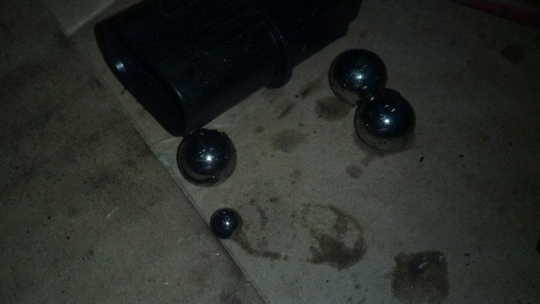

Was just about ready to put the tranny case halfs back together after installing LSD, I noticed an extra small ball sitting on one of my shift forks. Any idea where it goes? Is there more of this size I might be missing? I only see one. I have the other 3 larger balls.
Pics:
I need to figure this out ASAP, Help guys!

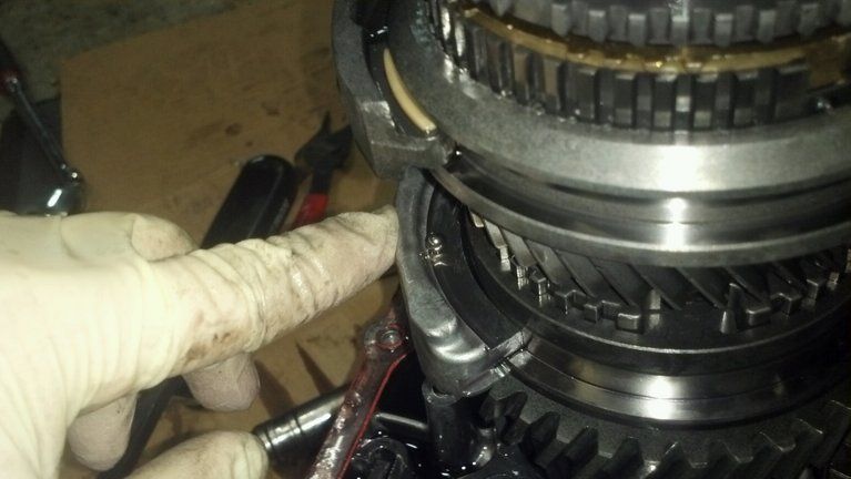

Not very useful, only thing I can think of is maybe a syncro ball? I didn't take any out but maybe somehow it came loose, gonna see if I can get enough movement out of a Syncro to knock a ball out. Any other ideas?

Ended up being one of the balls from a Syncro, of course putting that one back in resulted in the other 2 being flung across my garage but all back in.
