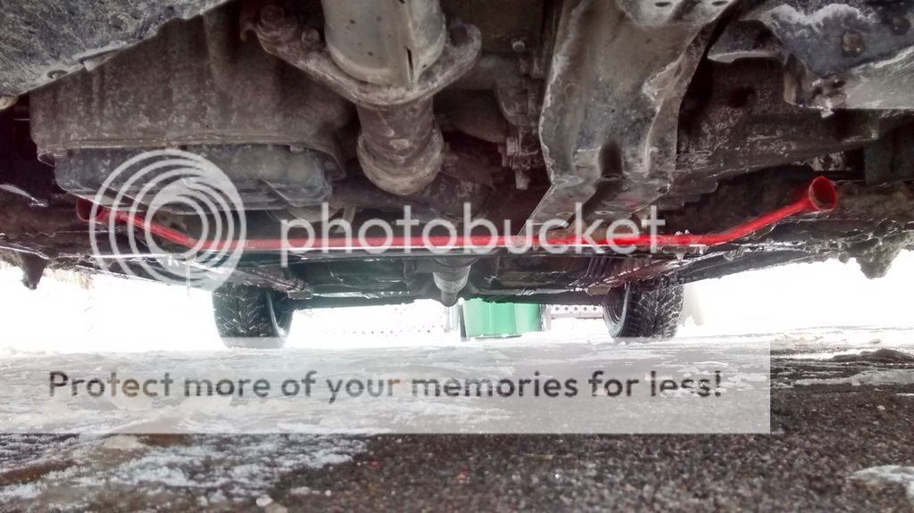

Hot damn, Martin. Your ride is like the pretty version of mine :p Glad to see you finally have a build thread up! Did you have any rattle problems with the lower tie bar?
Thanks. Actually, the under brace was by far the easiest part to install and hasn't given me any real problems. Only two bolts holding it in place, and with an impact gun, come out real easy. No rattle or anything, I just removed it because I was paranoid about it catching on some ice and either sheering off or taking some other vital suspension component/s with it. Ground clearance aside, no qualms with the UB.
Here's a better angle, excuse the salty mess.

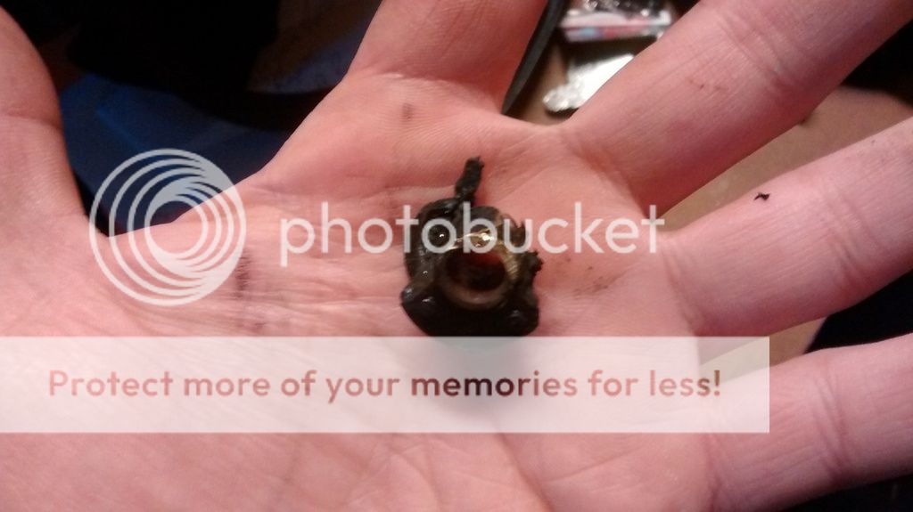

Cable bushings are in. Simple job became needlessly difficult when trying to pry off a stock bushing that was seized on real tight. Hit it with a propane torch, doused it in WD-40, grabbed it with Vice-Grips and knocked it out with a BFH.
Stock vs. TS bushing
What's left of the stocker
Finished product
