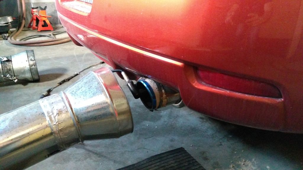

Catback is in, and it's loud af.
exhaust clip @ 4k rpm

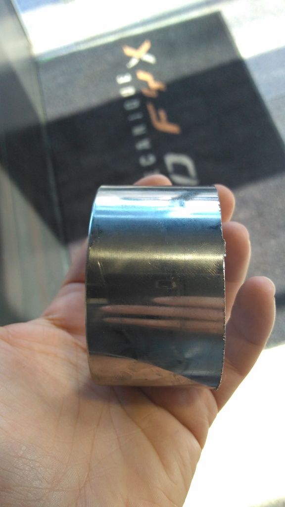

To anyone thinking of purchasing or installing this exhaust, keep in mind that it may not fit. Piping is too long and won't clear. Had to take a hacksaw to it and cut out a 1.5" section before the muffler meets the mid-pipe. Not a big deal, but a nuisance just the same.

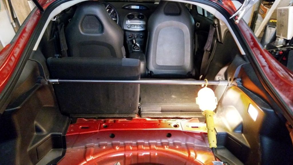

To anyone running a Tanabe STB (possibly other brands too) on a GT, it'll fit just fine over the stock bar. Saw it on Fabguy's build thread and tried it for myself
EDIT: Cusco bar has a circular plate that bolts onto the towers which probably won't work with the stock STB. Credit to Desert Rat for pointing that out
#60 · (Edited)

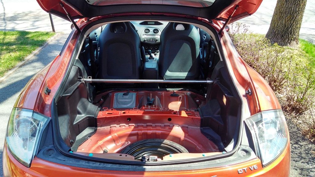

I'm still on winter rubber in freezing conditions, so I haven't pushed the car through any hard corners yet. When the time comes I'll definitely share my thoughts on it.
I can tell you that the installation was tricky. It requires all the plastic trunk lining to be removed (expect to break a tab or two doing it) and unbolting the seatback clips. Unfortunately, there's a plastic shroud partially covering the bolts which makes it a pain (absolutely need a 10mm box wrench, impossible to use a ratchet). Mounting the bar itself is another feat due to the difficulty in lining up the bolts and tightening them down while holding the bar. I'd recommend installing one plate alone first, then getting someone to help by holding the bar or lining up the bolts/torquing them down. Once it's in, it's another hassle to adjust the new seatback clips and get all the lining to go in right (as the clearances with the new bar are tighter).
It took my old man and I about 2 hours to do the work. For the price, it's worth the effort imo, and Rob is a really nice guy who's easy to work with. Buy it with the door pull brackets and he'll give you a deal.

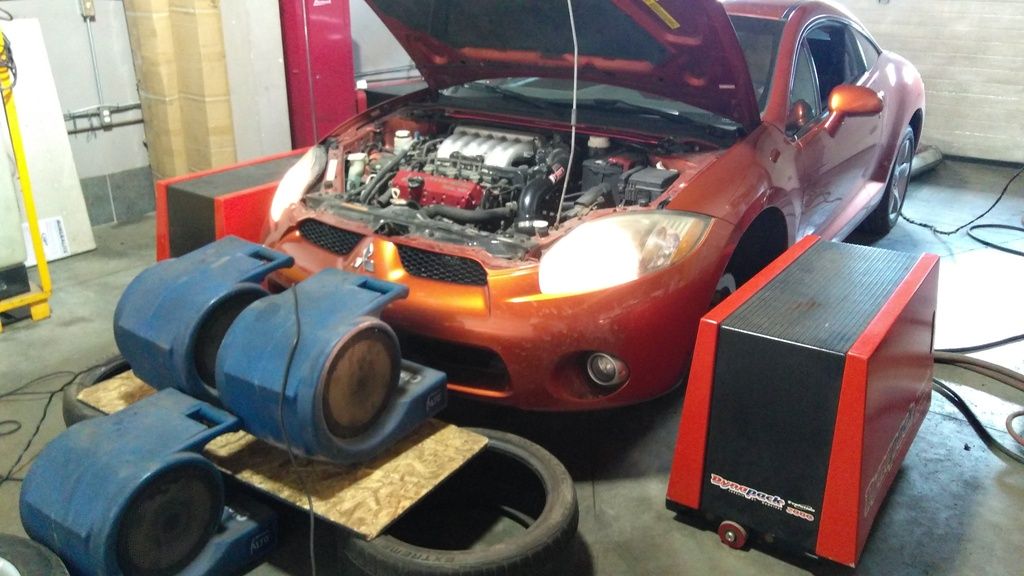

#65 ·

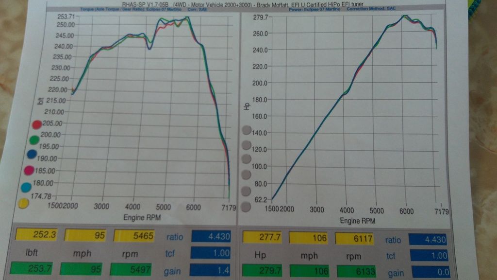

Spent the better part of yesterday flashing the car up in Gatineau with Hackish. It's set up to run 94 pump. Governor was bumped up to Warp 9 (510 km/h), rev limiter to 7200, sharpened up the throttle a fair deal and he even integrated a launch control feature (which unfortunately I cannot currently use because my clutch safety switch is defective). If anyone was contemplating getting tuned by Hackish, do it. Not only is he a great guy, but his work speaks for itself. He took his time to really get the tune running perfect and the car is noticably quicker. Should be putting down somewhere in the 280-290whp range.

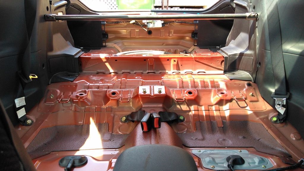

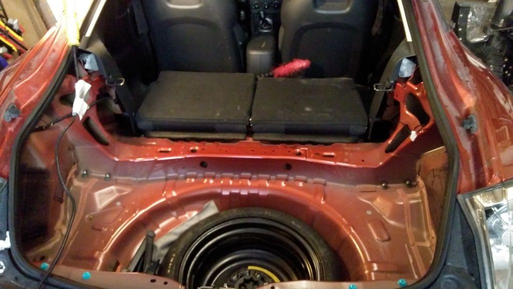

#69 · (Edited)
Had some time to kill today, so did the backseat and cargo liner delete. Two bolts, two nuts, one 12mm socket. Took maybe 5 minutes to do the work.
Weighed the back seats on my scale. The seat backs weigh 7lbs each (14lbs total) and the cushion weighs 8lbs. Which means a total weight savings of 22lbs. Not bad.
