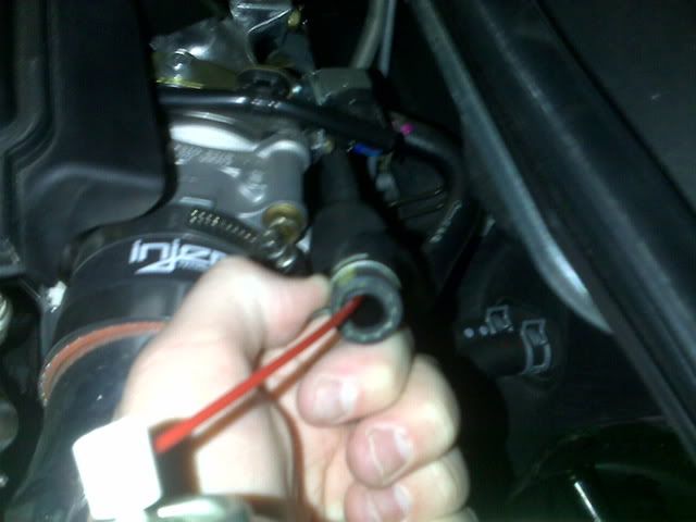

Open the hood, and look toward the engine from the front. Look at the back-right of the compartment by the battery, just to the left of the battery you will see your brake fluid container and this small hose, called the brake booster hose, plugged into a large circular black thing. Mine had blue writing on it.
Remove that hose by pushing the 2 clamp prongs together and pulling on the hose, so that you have the hose connected to the engine but not the brake booster. Here comes the 2 person part.

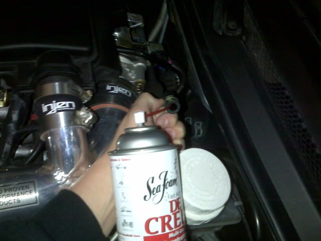

Take your can of Seafoam, and if you have the Deep Creep stuff, connect the little red tube to the can snugly (You don't want that falling into your booster hose :p). If you have the regular stuff, open it up.
Have your helper get in to the car, and put the key in the ignition, but don't start it. Work out some sort of signal so that when you're ready, your helper will start the car, in neutral, and keep the engine steady at around 1500rpms. When the car is started, start pouring/spraying the seafoam into the engine. It's going to start smoking from the exhaust like crazy, and bucking and misfiring, etc. Don't worry about that. You'll probably get a Check Engine Light too, not a problem.
Continue this until the can is empty or you can't stand to press the button any more, and have your helper turn the car off immediately after it's empty. If you didn't quite get the whole can in, no biggie, pour the rest of it into your gas tank.

#15 ·
Found it! Ha i used this thread to guide me through using the spray into Brake Booster vacuum line method and posted my response to give some credibility to the author in the wrong thread. So, nonetheless, after reading this thread last night, it brought to my attention that I'm willing to spend the $15 and give my car a little cleaning treatment (I've known about Sea Foam, just not any direct application methods besides pouring into the gas tank). This morning i picked up a a can of Sea Foam (spray) once i got to town (about a half hour drive). So after the drive the car was at operating temperature. I used the B.B. vacuum method. Once i got to my dad's house to run him around to take care of his errands, I had him help me out real quick and idle the car at 1500-2k RPMs (Car had initially started rough due to the vacuum line just sucking air, but once dad started applying some throttle it evened out a bit) while i sprayed ~3/4 of the can through the B.B. vacuum line and shut the car off. Next, i reattached the vacuum line to the B.B. and sprayed the remainder of the can into my gas tank. Then, i dropped my dad off for his errands and went for a good 50 minute cruise, driving the Eclipse "pretty" hard, keeping the RPMs up around-above 4k. She smoked quite a bit, but it's sort of wet outside right now so i couldn't really see much smoke while driving. In conclusion, I didn't get any service engine light and the car seems to be running great. So, i thought i'd write up my experience on here for reference of this method working pretty darn well.
